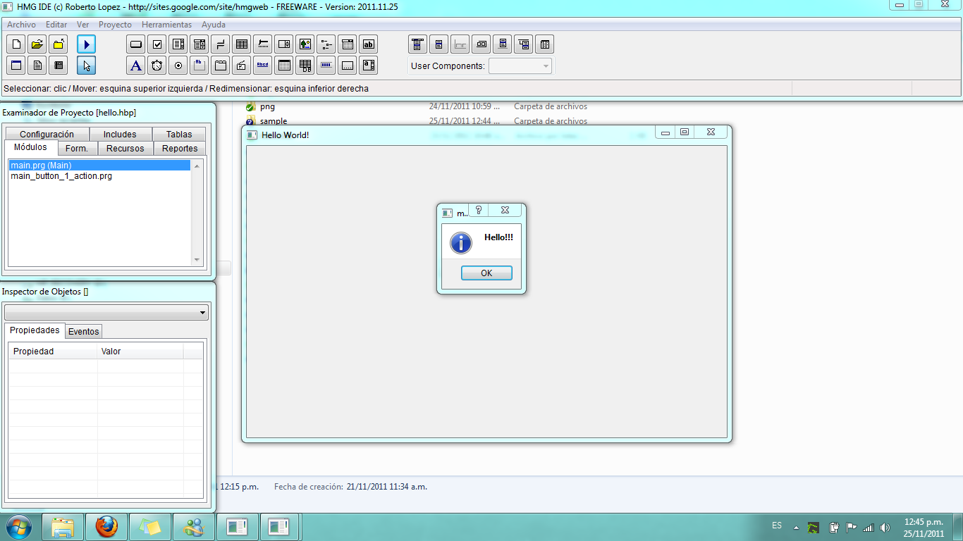

Re: HMG.4 IDE TEST 2011.11.25
Compila Ok.

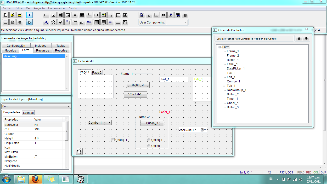

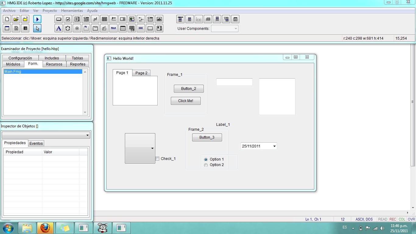

when you add a frame after other objects do not work the same examples of the Appendix
sample.zip

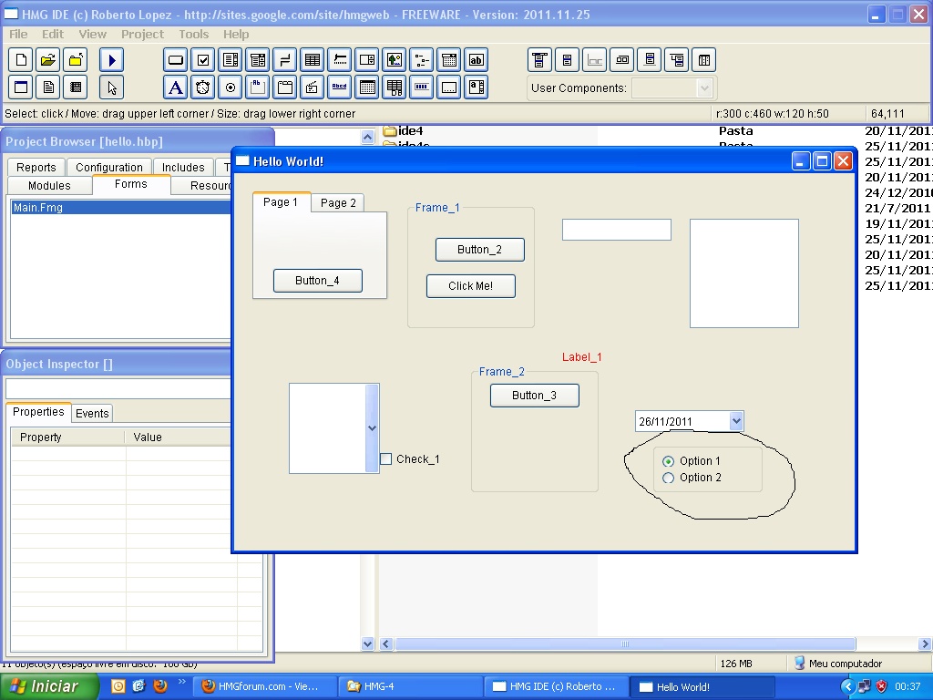

There is a problem with radiogroup frame around
jairpinho wrote:when you add a frame after other objects do not work the same examples of the Appendix
intenta cambiar el orden de los controles
despues compila ok
