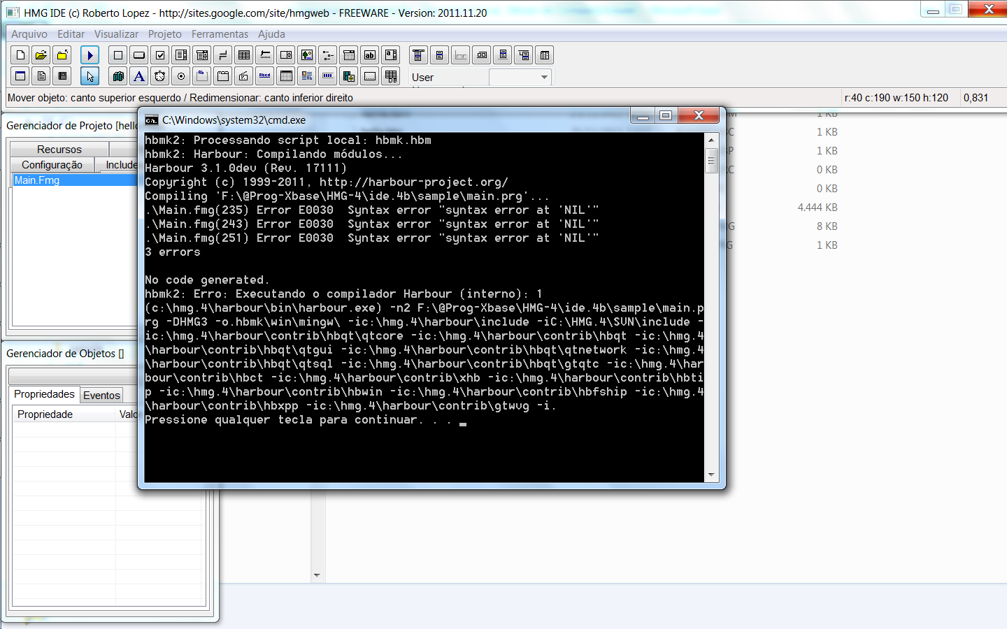

error while compiling
does not accept *.FMG attached zip attached
Main.zip
(1.73 KiB) Downloaded 485 times
