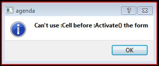

Builded executable give this unrecoverable RTE:
samples\agenda RTE
samples\agenda RTE

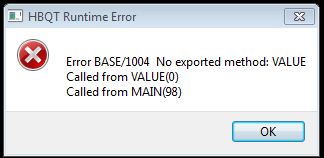

Button Box Demo 1 Error
Button Box Demo 2 Error

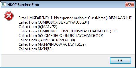

comboBox ( demo 1..2 ) : ok :) ; demo 3 ok but until enter data in oCombo3 :(
Combo Box RTE
Combo Box RTE

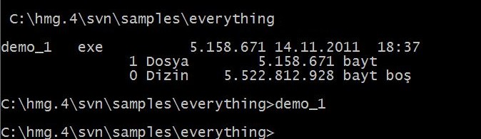

everything : Most wondered and most annoying :(
.exe built and run, but no activity :(
Only task manager will kill it :(
to be continued ...

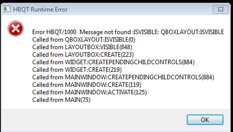

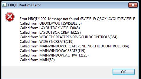

layout ( demo 1..6 ) :
Error HBQT/1000 Message not found : ISVISIBLE: QBOXLAYOUT:ISVISIBLE
Error HBQT/1000 Message not found : CLOSE: QBOXLAYOUT:CLOSE

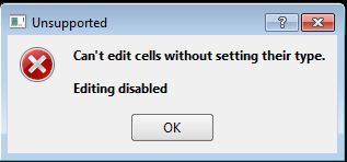

demo 6 : prg say : 'Test.PDF Created!'; not found such file
demo 7-8 : unrecognized errors occured: "demo_7.exe stop running" ( APPCRASH ? )

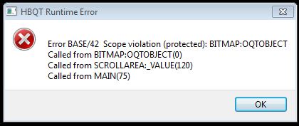

demo 2 :
ScrollBar Demo 2 - RTE
