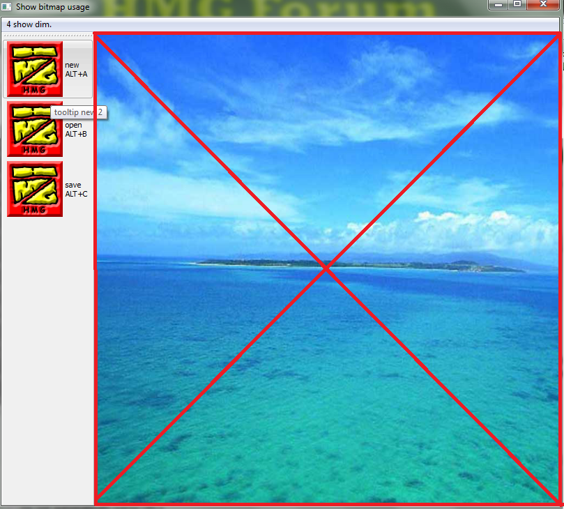

I'm working on a program where I have an image that is resized with the window and when I change the toolbar place the image is not resized. By this I thought to know this property. I know the correct thing to know the free area of the window ({top, left, width, height}) and resize the image in this area. Is that possible?
Below I leave an example: Put it in the folder: "\hmg.4\svn\samples\image"
Free area = area marked red
It is possible to know what the dimensions of this area and not the window ?
Best Regards,
Rossine.
Best Regards,
Rossine.

Hi Rossine
Luigi
In this moment I don't have a qualified answer because this is the "centralwidget area". I must investigate with QT. Your question sounds like Ricci's question: you can try this MainForm:QtParent:Width() and MainForm:QtParent:Height(). But this dim. are stable after all widgets are painted. To know when all events are done (at this moment) it's impossible because we need to use singleshot technique...and AFAIK not possible with current HbQt.Rossine wrote:It is possible to know what the dimensions of this area and not the window ?
