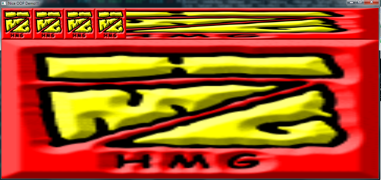

The problem is that all objects inherit the property "brush". You know how to do only "window" to use the property "brush" ?
Best Regards,
Rossine.

Rossine, to assign a brush only to your window background use this:
or with your enhancement of the basic class:
This code is a little bit better:
WITH OBJECT oWindow := MAINWINDOW():New()
:Row := 10
:Col := 10
:Width := 400
:Height := 400
:Title := 'Nice OOP Demo!!!'
:OnInit := { || oWindow:Center(), oWindow:GraphLabel:qtObject:setStyleSheet( "border-image: url('hmg.png');" ) }
:Row := 10
:Col := 10
:Width := 400
:Height := 400
:OnInit := { || oWindow:Center(), oWindow:GraphLabel:Brush("hmg.png") }

Re: Comand "DEFINE BKGBRUSH" in HMG.4
Hi Rossine.
Hi Rossine.
Yes it's possible, but IMHO usage of stylesheet, with customized commands, it can open problems.
Your example is fine, but please take a while to thinks about many users: someone want border, someone doesn't want, someone customize dimensions, etc. If I create a method like BackImage or BkBrush I have only one possibility: customizing the style sheet within command. But next time, someone wants a little different style and so on. I don't know.
I hope that my English and my explanation is clear
On the other hand, as I write to you, the usage of stylesheet can create problem as you shows in pictures. I had the same problems.
Before create this command/method, I think we must investigate: why child objects inherit background?
One problem is autofillBackGround(.T.), but I removed it. But this setting is fired on when you use "Backcolor" and - I think - "Color". Can you do some test about this?
A simple form with a background image, one label and one button very simple (no color, no background, only position and caption). If work fine, add a backcolor.
Please remember to update your HMG4 with SVN.
Cheers
Hi Rossine.
Cheers
No, not the whole stylesheet is lost with setStyleSheet(). It works as in XHTML, you only change these parts of the whole (unknown) stylesheet that you like.l3whmg wrote:On the other hand, you and Rossine use this syntax "::oQTObject:setStyleSheet( csetStyleSheet )".
In this way previous and/or different style will be lost. Isn't it?
I would prefer the first way by directly changing styles in program code (in OnInit() or later) than defining a lot of methods for that in the basic class. There maybe a hundred of style commands, impossible to write a method for each.l3whmg wrote:We can choose many ways, but we are developping a "general" library and not a "personal" library. I wrote this, because some time it's easy to take a way but can be dangerous. Today, you can use StyleSheet() method to handle this. Is there a problem with this method? We must solve it.
He he, I just used Rossine´s code without thinking ... you´re right.l3whmg wrote:Second: you use "border-image": what means? Is a CSS3 styling to use image as border..... I know "background-image" to be used to paint a background.....
More infos about Qt-style here: http://doc.qt.nokia.com/qq/qq20-qss.html
