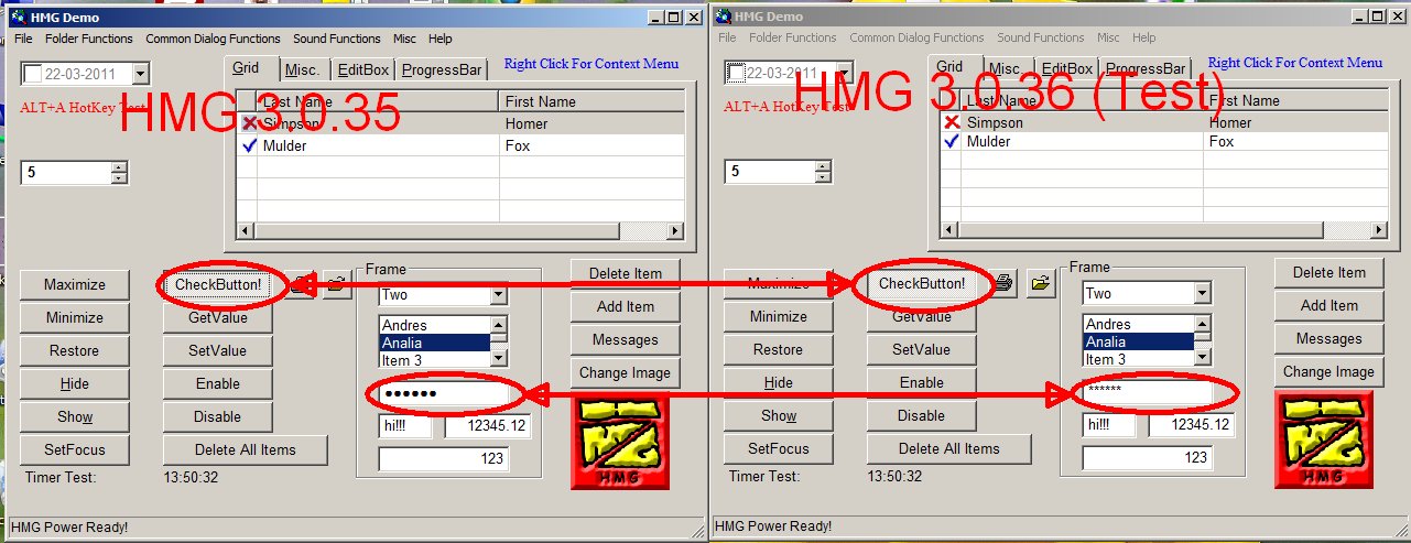

I saw some strange behaviors between 3.0.35 version and 3.0.36 (Test) version. I am illustrating the findings with a picture. Kindly see to it.
Is it ok? Or, why is it like that?
Also, we have to solve one bug now (some controls having black background in themed windows versions)

rathinagiri wrote:I saw some strange behaviors between 3.0.35 version and 3.0.36 (Test) version. I am illustrating the findings with a picture. Kindly see to it.
Hi Rathi,
The reason of aboved problem is absent of theme manifest in this demo's resources.
I've adde the following line in the file \hmg\hmg.hbc
sources=\hmg\resources\hmg.o
and this problem disappeared. :idea:
