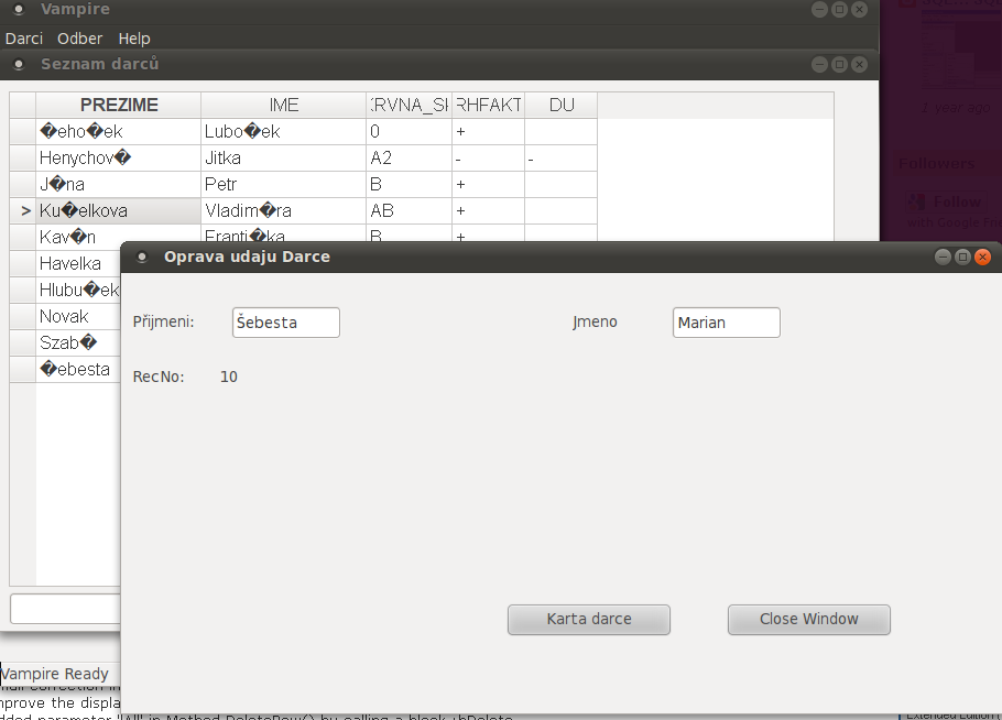

I'm new here, first time trying to make gui application. attached is small sample wich contain my first try.
I'm using harbour last compiled from svn
OS - Ubuntu 10.10
hmg - from svn at revision 509
Now questions:
1. Browsing database charachter's in names don't show as expected but terminal version work as expected in habbour
2. Clicking around on browse show difference on picked record and record in database as on attached picture, bigger database it is there are more problems with that. On edit window and print preview character's from database are shown correct.
3 How to lunch print preview with fit width activated
Thank you and best regards from Czech
Davor

Re: Newbie Question
There are problems in browse on record pointer.siki wrote: 2. Clicking around on browse show difference on picked record and record in database as on attached picture, bigger database it is there are more problems with that. On edit window and print preview character's from database are shown correct.
BROWSE uses a "call-back" to ask for the record data/colors etc. When you click on a cell it asks data for the record you are leaving (it must redraw the cell unselected) and the cell before after and the selected one.
These call-backs are "async", generated by Qt as it needs, and so it moves the record pointer ( recno() ) and sometimes it is not left on the selected cell ! So tou MUST NOT trust recno(), also on double clicks. Instead you have to retrieve browse:value that returns the browse row and move the pointer accordingly ! I'm trying to change browse code to sync recno() but it is really useful ?
Other tests with BROWSE (samples\browse\demo_5.prg) showed that using browse on a million rows dbf using DBFNTX makes the browse almost unusable. Using DBFCDX makes the browse really quick.

Re: Newbie Question
Hello mrduck
But how from browse:value to find actual record, or there are some other way ?
thank You and best regards
Davor
I think that is very important that browse update recno because after f.e double click we want to make some action print, edit, etc and we need for sure to print record pointed in browse not some other !mrduck wrote:siki wrote: 2. Clicking around on browse show difference on picked record and record in database as on attached picture, bigger database it is there are more problems with that. On edit window and print preview character's from database are shown correct.mrduck wrote: There are problems in browse on record pointer.
I have no problem with speed for nowmrduck wrote: Other tests with BROWSE (samples\browse\demo_5.prg) showed that using browse on a million rows dbf using DBFNTX makes the browse almost unusable. Using DBFCDX makes the browse really quick.
Davor
