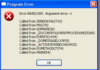

Conseguistes algun ejemplo ? Encontré este aqui:
#include "minigui.ch"

Pero está dando este error:

Passed a quite long time... but finnaly I backed to this matter.
Now with some more HMG knowledge in my small luggage ! :D
This error happen because in the previous code sample was missing COMMPATH definition.
In HMG instead of Minigui Extended we need to define thru SET COMMPATH TO command.
  • So added SET COMMPATH TO command.
  • There was also an hard execution when trying to the button EXIT. I replaced Form.Release by TerminateProcess()
  • Some other functions was added like: SetForegroundWindow and SetConsoleTitle.
  • Replace SW_MINIMIZE property by SW_HIDE for console opend session
  Based on Grigory MixedMode demo
  Adapted version for HMG
  By Pablo César Arrascaeta
  On February 23rd, 2015

Now is working in HMG and was clear out this question.
I hope you enjoy it ! :D
