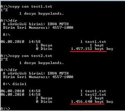

If you have a diskette drive on your PC, you can do this test:
copy con test1.txt   // I'll write someting on console, save it to a file name is : test1.txt
1^Z                  // write only one character ("1") and than press ^Z (EOF) (or press F6)
                     // this terminate writing and save the file
dir                  // show me list of files on this folder ( A:\ )
...                  // some info about disk
06.08.2010    14:58       1 test1.txt
                 1 file            1 byte
                 0 folder  1.457.152 bytes free
And than repete :
copy con test2.txt
1^Z
dir
06.08.2010    14:58       1 test2.txt
                 2 file            2 byte
                 0 folder  1.456.640 bytes free
File size values ( 1 byte for each ) is actual file sizes.
1.457.152 - 1.456.640 = 512 is space occupied on disk by each 1 byte file.
This is because OS allocates disk space to file as 512 byte unites per request. FE if file size is 513 byte, allocated space will be 1024 bytes.
This is for FAT16 file system and for relatively small media (diskette in our example). While media grown, this allocation unit size too will be greater.
In NTFS, file allocation system is totally different and more complicated.
PS: This little information dedicated to who search always a "tool" for every need. ;)
