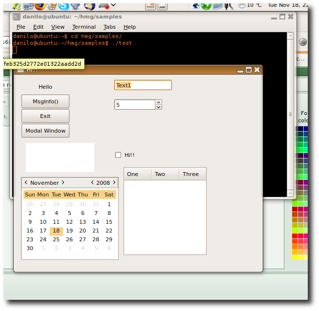

Here a screenshot of test app:... the hmg/samples/test running...

Re: HMG-Linux warning of sample hmglow.c are removed...
very nice !!
