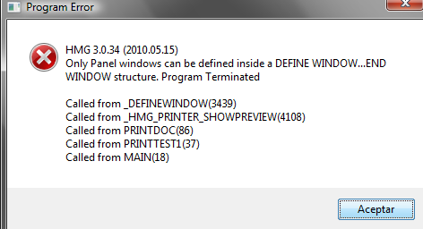

I'm getting the error that I show in the picture attached, please take a look.
Also attached a small example (based on HMG examples).
If you put as a comment line 16 (BUTTON btnAcepta...), the example generates the error as attached image.
And if you put as a comment line 17 - printTest1 () and uncomment line 16, then the example works fine.
The question is why?, and if I'm doing something wrong.

The problem is that you are starting a print preview before activating/ closing the main window definition.
So, print preview attempt to define (and activate) its own window 'inside' a not closed define window... end window structure, giving you an error message.
This behavior is by design.
