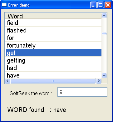

SEEK with SOFTSEEK clause
moves the pointer in the database
to the last record displayed in the grid,
see the program and the picture below.
Grid & SoftSeek

Let's start again in the different way.
Now in the demo we have 2 child forms, first with the grid, second without the grid, both performing SOFTSEEK.
I expect in both forms the results of SOFTSEEK to be the same, but the grid is responsible for the differences.
The modified demo attached below.

Re: Grid & SoftSeek
Each time that the operating system needs to repaint a specific region of a grid, it sends a message that is processed by HMG.Czarny_Pijar wrote:Let's start again in the different way.
According to the logical row of the cell that needs be repainted, HMG moves the record pointer to such row to pick the required value to update the cell.
This process in initiated automatically by the operating system according its own needs, so, there is no way to modify this process.
Of course, HMG could backup the record position, move it to do the update and the restore it to its original position, but, such process could slow down grid a lot.
The bottom line is that there is no way to predict where the record pointer is at a specific moment, because it is moved according to the region of the window that the operating system needs to repaint in a specific situation.
This is the reason because I've added the 'recno' property. Via this property you can know the record number of the selected row, in the case that you need it to do something with it.
If you don't like this way, you could still using browse control and setting browsesync to 'on'.

Roberto Lopez wrote:If you don't like this way, you could still using browse control and setting browsesync to 'on'.
I've finally spotted the quirk:
I have to move the command 'grid.value' to the bottom, in order do NOT interfere with the data related to the current pointer of the database.
BTW, the other HMG-apprentices, beware: grid.value and grid.OnChange are not what they seems to be, at least for me
