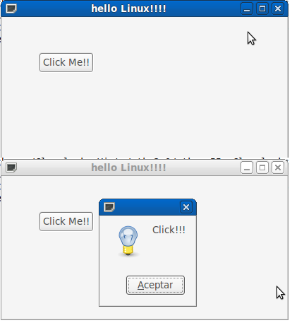

Posts: 433
Re: Hello Linux!!!
Post by jparada »
Thanks a lot Roberto, now works fine
I attached picture, please take a look
Thanks
Best Regards
Javier
Re: Hello Linux!!!
jparada wrote:Hi,
Thanks
Best Regards
Javier
Congratulations!
