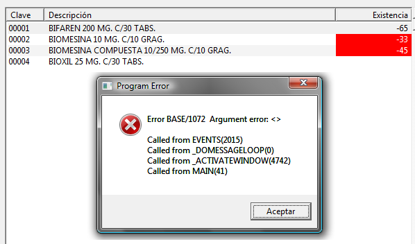

After getting that negative numbers are deployed with the color red (Thanks again Roberto).
Now I also like to do the same with DynamicBackColor property, and I try to do exactly as I do with the property DynamicForeColor, but I could not do it.
I attached image about the error that I am getting, please take a look, and also attach a small example, please take a look too.
Please can someone tell me how to fix it?
Thanks
Best Regards
Javier
Thanks
Best Regards
Javier

Re: Forecolor in grid displays the records alternating color
Hi Javier,
Change the two lines (33,34) with this...
DYNAMICBACKCOLOR { bckColor, bckColor, { || If( g_existotal < 0, { 255, 0, 0 }, If( RecNo() % 2 == 0, { 255,255,255 } , { 244,244,244 } ) ) } } ;
DYNAMICFORECOLOR { bckFore , bckFore , { || If( g_existotal < 0, { 255, 255, 255 }, {0,0,0} ) } } ;
