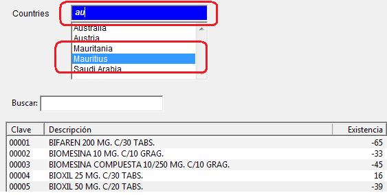

I'm trying to do a search in a grid control and textbox control (QuickSearch example by Esgici).
But I'd like to Writing to the textbox control, grid control gets the focus (as well as in the example Combosearchbox).
I already have taken a look at Combosearchbox source code, and I saw that this "trick" is done by the following line:
SetProperty (ThisWindow.Name, "_csList", "VALUE", 1)
But if I do something similar in the Grid control does not work, and I do not know how to do this.
Someone could please give me an idea of how to implement this. and of course I would do the same, as does the combosearchbox control, also use up and down key.
I appreciate any help or advice you can show me about this implementation.

Hi Luigi,
Thanks for answering, but I think your example is very similar to the example I said (by Esgici), and does not work the way I like to implement.
I would like the Browse control, get the focus (selected cell, blue color), while you type something in textbox control.
Just like the example ComboSearchBox.
Thanks
Best Regards
Javier

This I already knew it, I have already taken a look at the source code and I know it is a "trick" with a modal window.
What I do not know is how to achieve that while writing to the textbox control "apparently" the focus (highlighted item) is placed on the element that matches in the listbox control.
The only thing I've seen, is that apparently, this line:
Does the trick, but... I'm not sure about it.
But doing something like that does not work with the Browse control (in my case, so far I do not use the Grid control).
Maybe someone can provide any help or tip to implement the "trick"
So my specific question, whether it is possible (almost always be around), that while typing in the textbox Grid control gets the focus (entire row selected, in this case blue), and it is possible, my next question is , how to do that.
I appreciate any help.
Thanks.
Best Regards
Javier

Everything works fine. The only problem is we can not the blue background color as in listbox even though the grid item is selected. The reason is, listbox is by default having blue color for the selected item both in focus state and non-focus state. Where as, grids by default make it grey when not in focus.
If we can get a work around using dynamicbackcolor, this would also be solved, I think.
jparada
Posts: 433
Re: Something like combosearchbox, but in a grid control
Post by jparada »
I appreciate your effort and your work, your example works well and includes "almost" all the features that ComboSearchBox have, except one, as you well commented which is that the Grid control does not get the focus.
Thanks for this explanation, I did not know that this is the normal behavior of the listbox control.
I have no ability to implement a "workaround", perhaps someone can help here.
Anyway, if this is not possible, then I will have to try with other alternative, or use "at the moment" ComboSearchBox, but once the event on change works well.
Thanks for your effort
Best Regards
Javier
