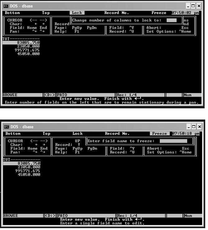

By the way, this was LOCK or FREEZE ? It seem to me in old days ( happy dBase and Clipper days ;) ) these was two separate process.
Now, we need waiting test results by Marek ;)
Best regards and hearty thanks Roberto :D
Re: I had an epiphany (another boring story :)
esgici wrote: ...
Sorry, I remember wrong :(
In Clipper I can't found LOCK, and description of FREEZE method of TBrowse class is :
Freeze (Assignable)
Contains a numeric value that defines the number of data columns
frozen on the left side of the display. Frozen columns are always
visible, even when other columns are panned off the display.
oTB:Freeze := 1
And, in dBASE side :
Lock and Freeze in Browse of dBase
Of course, this doesn't means "everything must be in this way", only a little remembering.
Saludos, regards
