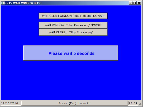

Wait window is visible not enough
Hi All !
I prepared an improved version of our colleague Gert:
#define C_LIGHTBLUE  {165,175,245}
Function Main()
Set Century On
DEFINE WINDOW Win_1 ;
    AT 0,0 WIDTH 600 HEIGHT 450 BACKCOLOR BLUE ;
    TITLE "WAIT WINDOW DEMO" MAIN
    @ 030,160 BUTTON Button_1 CAPTION 'WAIT/CLEAR WINDOW "Auto-Release" NOWAIT' ACTION Test1() WIDTH 290
    @ 070,160 BUTTON Button_2 CAPTION 'WAIT WINDOW   "Start Processing" NOWAIT' ACTION Test2() WIDTH 290
    @ 100,160 BUTTON Button_3 CAPTION 'WAIT CLEAR     "Stop Processing"       ' ACTION Test3() WIDTH 290
	DEFINE STATUSBAR FONT  "Courier New" SIZE 9
		DATE  WIDTH 85
		STATUSITEM HMG_PadC("Press [Esc] to exit",64) ACTION ThisWindow.Release RAISED WIDTH 450
		CLOCK WIDTH 65
	END STATUSBAR
DEFINE WINDOW Win_Wait AT 0,0 WIDTH 400 HEIGHT 64 ;
    TOPMOST NOSHOW NOCAPTION NOSYSMENU NOAUTORELEASE BACKCOLOR C_LIGHTBLUE
    @ 20,10 LABEL L1 VALUE 'Please wait...' WIDTH 380 HEIGHT 20 CENTERALIGN ;
            FONT 'ARIAL' SIZE 14 FONTCOLOR BLUE BOLD BACKCOLOR C_LIGHTBLUE
CENTER WINDOW Win_1
CENTER WINDOW Win_Wait
ACTIVATE WINDOW Win_1, Win_Wait
Function Test1()
Local i
Win_1.Button_2.Enabled := .F.
Win_1.Button_3.Enabled := .F.
Win_Wait.show
For i=1 To 10
    Win_Wait.L1.VALUE := 'Please wait '+Alltrim(Str(i))+" second"+If(i=1,"","s")
    hb_IdleSleep( 0.5 )
Next
Win_Wait.hide
Win_1.Button_2.Enabled := .T.
Win_1.Button_3.Enabled := .T.
Function Test2()
Win_1.Button_1.Enabled := .F.
Win_Wait.show
Win_Wait.L1.VALUE := 'Please wait...'
Function Test3()
Win_1.Button_1.Enabled := .T.
Win_Wait.hide
I hope you enjoy it and be usefull too :!: :D
