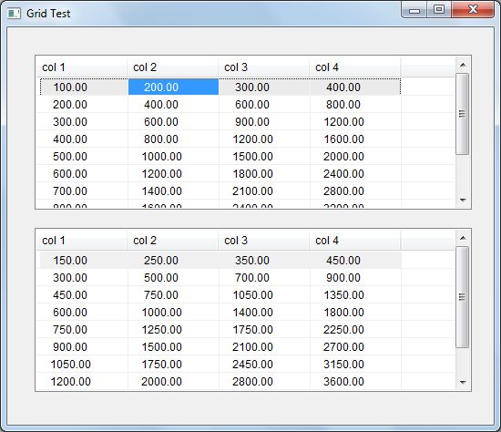

sudip
Posts: 1456
Location: Kolkata, WB, India
Re: Problems with Grid in Edit mode
Post by sudip »
Hello Roberto,
Sorry for the delay. I created a small sample to explain what I want to say.
This sample has 2 grids. 1st grid is Cellnavigated and 2nd grid is not Cellnavigated. 3rd col for each grid is deactivated.
For 1st grid, when I go to 2nd col in edit mode, pressing Enter goes to 3rd col, but IMHO, it should go to 4th col, which actually works for 2nd grid (when cellnavigation is .f.).
For 2nd grid. I pressed Enter to go to edit mode. First I was in the 1st col. Then I pressed Enter to go to 2nd col. Then I clicked on the 1st col in the same row. But, the cursor went to 4th col. May be I am wrong, but IMHO it should come out of edit mode. But, when I went to edit mode by double clicking on 2nd col, doing the same thing, takes me out of edit mode, which is, IMHO, fine.
sudip wrote:Hello Roberto,
I've tested and understood you point.
When you are in non-cellnavigated grid and start editing, you are editing an entire row, so, this is the reason because the focus jumps automatically to the next available cell to edit and edition starts immediately. This is reasonable since individual cells are not navigable.
In cellnavigation mode you are not necessarily editing an entire row. You select a cell to edit and press <enter> to start editing.
Besides that the non-editable cells are 'navigable', so, skipping cells avoiding navigation because they are not editable, could be a bad thing in certain situations.
By the other hand, I understand that is more comfortable and maybe more desirable the behavior that you propose.
I'll think on that before take a final decision...
