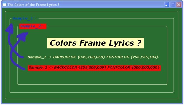

Hi, Silly question
When I create a Frame the lyrics, I can not change color, always
are blue.
I simulated two examples:
Prime Example Lyrics: Lyrics Yellow, Green Fund
and Second Example: black lettering and red background in the Label so
be seen, but in the Frame Lyrics remain the Blues, the only change
funds of the letters.
My question is can change the color of the letters of the Frame?
A greeting
Marco Letras Colores
Hola, pregunta tonta
Al crear un marco de la letra, yo no puedo cambiar de color, siempre
son de color Azul.
He simulado dos ejemplos:
Letras ejemplo: Letras Amarillo, Verde Fondo
y Segundo ejemplo: fondo negro y letras rojas en Label se ve,
pero en el marco letras siguen siendo color Azul, el único cambio
los fondos de las letras.
Mi pregunta es, puede cambiar el color de las letras del Frame?
Un saludo :?:
mUSTAFA
Frame.zip
(692.64 KiB) Downloaded 276 times

mustafa wrote:...
Hello Mustafa,
Please take a look for the following topic
viewtopic.php?f=5&t=249
I hope that give you an idea :idea:

Re: Colors Frame Lyrics ?
mustafa wrote:Frame Colors Lyrics
Hi, Silly question
are blue.
A greeting
son de color Azul.
Un saludo :?:
mUSTAFA
Some controls do not respond to standard color processing when themed XP/Vista/Seven are active.
This was deliberately done by theme designers.
In such cases, to keep compatibility you must to suppress line #6 in \resources\minigui.rc, recompile resources and your application.
The overall idea is most controls look the same across the applications.
