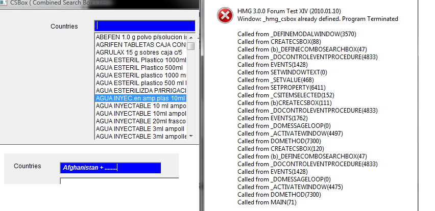

I just test the sample ComboSearchBox, and try to do something like this:
aCountries: = myList ()
Asort (aCountries)
FUNCTION myList ()
LOCAL aList: = ()
USE catpisa
// Go Top
WHILE! EOF ()
AADD (aList, catpisa-> name)
SKIP
ENDDO
RETURN ready
And the result is correct as you can see in the figure attached, please take a look, but ... when trying to select the item (double click or enter), displays the error that also attached a picture, please take a look too.
The question is if I'm doing something wrong, my little example of code needs to be changed?., If so, how?, please?, Can someone help me?.
BTW, when you choose a list item and the item is placed in the textbox, if you write anything (I mean, selected item + writing something else), does not display the list again (I mean not validated again ), And this may be a problem because then the element in the textbox, then does NOT exist in the list.
Please I await your comments.
Thanks
Best regards
Javier

Following this thread,
If I make a small change to the code:
FUNCTION miLista()
	LOCAL aLista := {}
	USE catpisa
	//Go Top
	WHILE ! EOF()
		AAdd( aLista, catpisa->nombre + CRLF)  // Add CRLF
		SKIP
	ENDDO
RETURN aLista
So, there is no error that I mentioned before, but is not the desired behavior.
Can someone please provide some tips to improve this implementation.
Thanks
Best Regards
Javier

Re: Error when trying to recover items from Dbf, ComboSearch
Hi Javier,
It is not related anyway with ComboSearchBox! It is related with the character type field value and the textbox on change event behaviour.
This can be seen with a simple sample here.
Let us wait for Roberto's answer.
