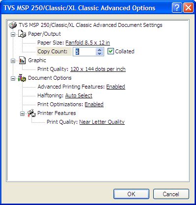

Hi Swapan,
I have 3 local (virtual) printers installed in my computer. No. of copies is enabled in only one of them (BULLZIP PDF PRINTER).
But I just tested C:\hmg\SAMPLES\PRINT\ImageFromResource\Bmp. When I choose select printer with settings, it gave me option for specifying no. of copies as follows.
So, IMHO, there is a problem in case of preview (if I am not wrong).
With best regards.
Sudip

Number of copies will be enabled only when the printer driver supports it, so it depends upon the printer you are using.swapan wrote:Can I accomplish the job using Report Writer?
