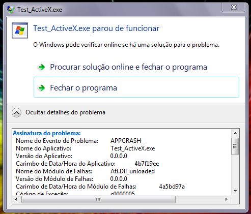

Roberto, i´ve a little doubt about activeX control.
I´ve a little project that i did for tests (is attached in this post).
Well, in this project i have a main ("Main.FMG") window with a button that call another window ("Test.FMG") that have a activex control. When a close the second window ("Test.FMG") i got error message of windows OS. When i not have the error on close the Test.FMG window, i click on the button of my MAIN window for call the second window again, so i got the same error again. Please, so kind, see the image bellow.
My doubt is: I can´t call a window with activeX control defined more than one time?!
I´ve use Windows 7 Ultimate version with theme Aero Default.
PS: Sorry for disturbing, and sorry my bad english.
With kind regards,
