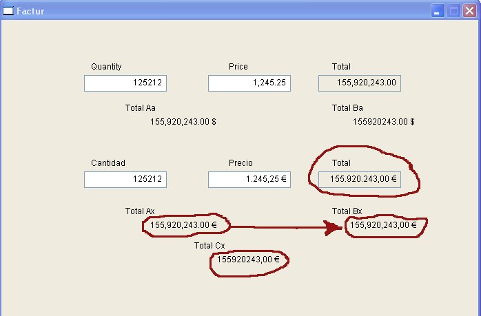

has been achieved partly results
Hola Roberto
Referente a tema que ha planteado Luigi
Yo tambien hace algun tiempo plantee el problema que existe en
la parte de Europa Zona € con los decimales pues las facturas
se emiten con decimales con la "," no con el "."
Se me ocurrio hacer algunas pruebas en poner el Total de una factura
en un valor LABEL y solo he conseguido el resultado a medias
en la parte superior de la impresion de pantalla es sin el Numeric INPUTMASK "99,999,999,999.99 €" FORMAT 'E'
y en la parte inferior se puede observar que en el Total del TEXTBOX
se ve correcto la forma de los puntos y comas con el simbolo del €
en Cambio en los LABEL que hay tres muestras Ax, Bx,Cx
se ha conseguido parcialmente los resultados
Prix.zip
(715.08 KiB) Downloaded 490 times

Re: Numeric InputMask
A screenshot :oops:

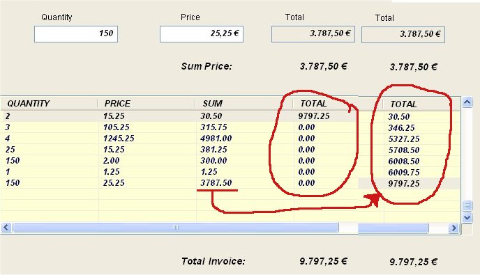

Hello Roberto
It is these very busy, but the issue of the decimal comma instead of
I point that works very well in the TextBox with the formula is added
At InputMask NUMERIC field "€ 9,999,999.99" FORMAT 'E'.
Anyway I've experienced a bit as would be the result in a LABEL
I made it to look like in the textbox, but never exceeding the number of
€ 999,999.00 since I've only managed to replace "," by "." And vice versa.
In the Browse is not the figures that would have to carry "," I experienced
A little and in the Browse is more complicated but I think you could do in deception
Has been achieved in the LABEL and the numbers are not in column.
Another issue alien has this problem is that I could not get in the column of
Total amount to be placed just before you save it in the record sum
Total attached a picture I have placed a screen with fiction as would
To be, not whether the formula of European format has been experienced in €
Printer is an issue that worries me very much because here in the European Community
If an application is made has to carry the book. “.” And “,” instead.
Excuse me for bothering teacher, a warm greeting
Hola Roberto
Ya se que estas muy ocupado, pero el tema de los decimales con la coma en vez del
Punto veo que funciona muy bien en los TEXTBOX con la formula que se le añade
Al campo NUMERIC INPUTMASK "9,999,999.99 €" FORMAT 'E'.
De todas formas he experimentado un poco como quedaría el resultado en un LABEL
He logrado que se vea como en el TEXTBOX siempre que no sobrepase la cifra de
999.999,00 € pues solo he conseguido remplazar la “,” por el”.” y viceversa .
En los Browse tampoco se ve las cifras que tendrían que llevar “,” he experimentado
Un poco y en el Browse es más complicado pero creo que se podría hacer en engaño
Que se ha conseguido en el LABEL y los números tampoco se ven en columna.
Otro tema ajeno ha este problema es que no he conseguido que en la columna de los
Totales se coloque la suma anterior solo consigo que se salve en el registro la suma
Total en una imagen anexa he colocado un Pantallaza con la ficción como tendria
Que ser, no se si la formula de formato Europeo del € se ha experimentado en
Impresora, es un tema que me preocupa mucho pues aquí en la Comunidad Europea
Si se hace alguna aplicación contable tiene que llevar los “.” Y las “,” en su lugar.
Perdone maestro por molestarle, un cordial saludo
PrixE.zip
(733.23 KiB) Downloaded 546 times
Posts: 1177
Un Screen
