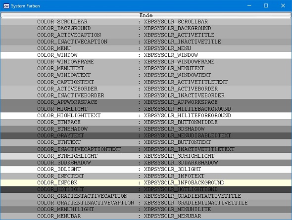

i have a DBF with my own Color. i have "Read" (GetSysColor()) those 30 Color from Skin Theme Color e.g. Office 2009
or iTunes
so User can choose what Theme Color he/she want.
i like Windows 10 Darkmode and this are my Color
all my Xbase++ App use same THEME.DBF so they look same
have not test it yet with harbour / HMG but with Xbase++ i have to use Ownerdraw to "overrule" Windows (Theme) Color.
i have only 1 Problem : get "automatic" Scrollbar to paint it black ... :roll:
