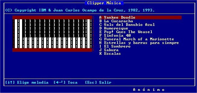

Re: How to speak your PC./ como hacer hablar tu pc.
Here I leave a screenshot of Clipper
- Clipper.jpg (51.75 KiB) Viewed 7967 times
