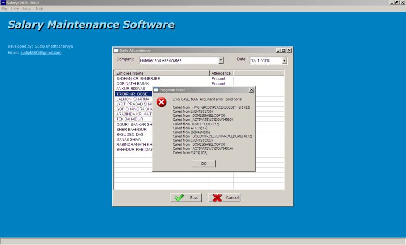

But, working on celled grid with combo box I found some problems. The grid has 3 columns. 1st column is hidden by setting width 0, 2nd column is shown, but 1st and 2nd column is made readonly using colmunwhen as .f. . 3rd colmun is combobox control. After selecting combobox, when I pressed enter or double clicked on 2nd column (in grid it is shown as 1st column) I got following error.
Date:13/01/2010 Time: 00:30:59
Error BASE/1066 Argument error: conditional
Called from _HMG_GRIDINPLACEKBDEDIT_2(1722)
Called from EVENTS(1735)
Called from _DOMESSAGELOOP(0)
Called from _ACTIVATEWINDOW(4560)
Called from DOMETHOD(7277)
Called from ATTEN(17)
Called from (b)MAIN(86)
Called from _DOCONTROLEVENTPROCEDURE(4872)
Called from EVENTS(1328)
Called from _ACTIVATEWINDOW(4514)
Called from MAIN(108)
I am also sending my unfinished project source code
Salary.zip
(24.54 KiB) Downloaded 305 times
Please check Atten.prg and frmAtten.fmg for the problem
Thanks in advance :)

I'm unable to build it.
I get a lot of undefined reference errors.
Could be you so kind to reduce to a small sample ?
TIA.

Yes, Master Roberto. I shall do it :) but it will take some time :) And it's positive side will be, during creation of Small sample I may found "my" error :lol:
BTW, I have sent whole project along with sample data (as shown in the picture). The project file is Salary.hbp. I compiled just it again with IDE.
But, I shall definitely send you a smaller sample :)

Was MY ERROR :)
Please, search for all return statements without a value in the function _HMG_GRIDINPLACEEDIT and give it a '.f.'.
It should fix it.
