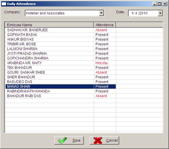

Hello Friends,
I have a grid with 3 columns. I am able to change forecolor of 3rd column based on the value of it. But I can't change forecolor of other columns based on the value of the 3rd column (which is a combobox control). Please check following image (I hide 1st column by setting it's with as zero)
I used following code
fColor := { || if(this.cellvalue == 1, { 0, 0, 0 } , { 255,0,0 } )}
and set DynamicForeColor of the grid to
{{||{0,0,0}}, {||{0,0,0}}, fColor}
Is it possible to change forecolor of 2nd column based on the value of the 3rd column?
Thanks in advance.
With best regards.
Sudip
With best regards,
Sudip

Re: DynamicForeColor of Grid
sudip wrote: Is it possible to change forecolor of 2nd column based on the value of the 3rd column?
Theoretically yes :)
You should ask for the 3rd column value using 'cell' property.

I used
Private fColor := { || if(getproperty("frmAtten", "grdAtten", "cell(this.RowIndex, 3)") == 1, ;
But all rows became red :(
I am sure I made something wrong with calling GetProperty() function. ;)
sudip wrote:Thanks a lot :)
I used
With best regards.
Sudip
Please, send me the complete sample to test for a possible bug.
