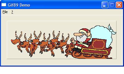

Hello Friends,
I want to present a small GIF animation demo based upon the Harbour TGif class.
 * MINIGUI - Harbour Win32 GUI library Demo
 * Copyright 2002-09 Roberto Lopez <harbourminigui@gmail.com>
 * Based upon sample Minigui\Samples\Advanced\AnimatedGif
 * Author: P.Chornyj <myorg63@mail.ru>
 * Harbour TGif class
 * Copyright 2009 Grigory Filatov <gfilatov@freemail.ru>

Your comments are welcome :!:
Tgif image
Tgif image
tgif.zip
Demo application
(439.31 KiB) Downloaded 584 times

Hello,
The command DRAW PANEL exists in the HMG Extended Edition.
The new TGif class will be available at the next buid of HMG EE :arrow:
