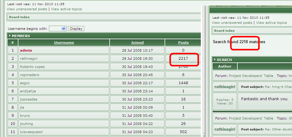

Believe it or not, we are approaching the end of the script possibilities of phpBB. I know at least one forum (http://forum.cdaction.pl/) where there have been complications (loss of the posts) because too many posts in one thread. (Now they are using 'IP.Board'). I strongly reccomend you to finish this thread and start a new one, namely:

Re: Welcome to the Project Developers' Table
Is it? I think there might be some other problem but not PHPBB. I know a PHPBB board wherein we have threads going up to 5000 pages. :)

Post by Czarny_Pijar »
I see the very first signs of loss of integrity of the database. It is of course nothing compared to the losses suffered by my colleague on the above-mentioned forum (about 1,500 of the total 7,000 posts). Sorry, I will no longer scare about this, nobody likes Cassandra.
Nothing to worry. From the very beginning I had not synchronized the user posts. Now it is ok.
