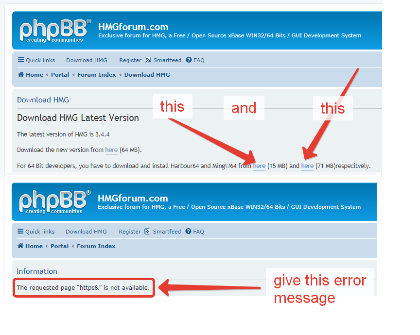

A download error in HMG 3.4.4: :(
Re: HMG 3.4.4
Posted: Tue Jan 09, 2018 5:17 pm
Thank you Esgici. Now rectified.
