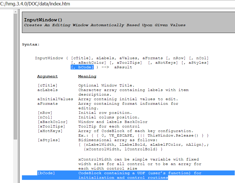

Function InputWindow()

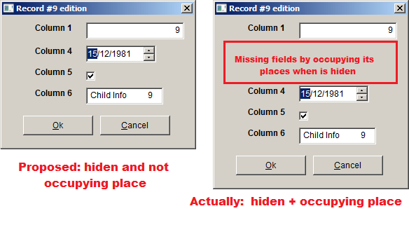

See my suggestion in images:
That's incridible how Grids are so complex control. Can I go ahead with my thinking or have you ane better idea ?
Re: Function InputWindow()
Of late, I too have re-considered my idea and thought that it will further complicate the things.
I think the first option (hidden and not occupying) would be good. Those controls might not be visible.
Hola Pablo César,
Voto por la Primera Opción!
Gracias Javier por tu interés y opinion.
Muchas veces tenemos que ejemplificar con imagenes para hacerse entender mejor.
Que bueno que se entendió lo pretendido. :)
