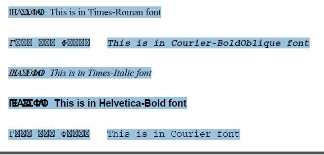

Please check the following. When I use the CP1253, I do get the correct language but the spacing betwwen the characters in the pdf print is wrong. It is too small, so the characters in a word are placed almost on top of each other. See the example.
It shows the definition of the code page and how it is printed.
Any help will be appreciated.

Thanks for reporting. Please upload the sample prg after zipping. Or send to my email id srgiri@dataone.in
FYI Character spacing feature can be added.

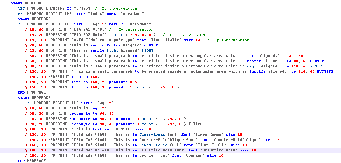

This is how I have received. But your version in the picture is different. Can you please give the exact one as in your picture above?
@ 10, 60 HPDFPRINT 'ÃÅÉÁ ÓÁÓ ÖÉËÏÉ' // My intervention
@ 15, 20 HPDFPRINT 'ÃÅÉÁ ÓÁÓ ÐÁÉÄÉÁ' color { 255, 0, 0 } // My intervention
@ 15, 100 HPDFPRINT 'ÁÕÔÏ ÅÉÍÁÉ Ýíá ðáñÜäåéãìá' font 'Times-Italic' size 14 // My intervention
The version is the same.
In your Notepad++ at menu “Enconing in “-> “character set”, select Greek-> windows -1253, maybe this resolve the problem.

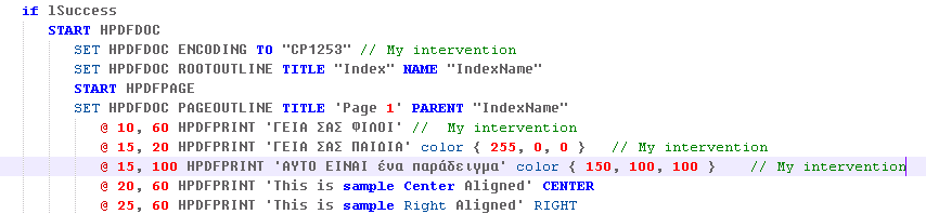

Hi rathinagiri
This is in photo, part of the code with Greek characters
and the same code with Notepad++

and the code...
