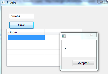

Hi All,
After test a lot of times I discoverd that with HMG.3.1.1, the control textbox
some times doesn´t return the value
aTemp2[2] := Main.Text_1a.Value
Prueba img_1.png (36.9 KiB) Viewed 9043 times
It has to show "Pruebax" but show only "x"

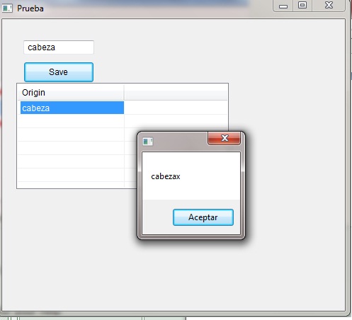

I went to C:\hmg\SOURCE\SET_COMPILE_HMG_UNICODE.ch
and comment the next line
//#define COMPILE_HMG_UNICODE
and then rebuild the hmg libraries and compile again
Prueba img_2.png (37.96 KiB) Viewed 9043 times

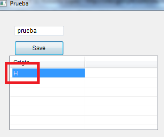

Aparently all was well, but i realized that the Grid control wasn´t display correctly
Prueba img_3.PNG (14.46 KiB) Viewed 9043 times
Atached please find example.
Thanks for your help
Ed

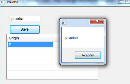

Insisto... a mi tu aplicación corre bien....

danielmaximiliano wrote:TextBox controls work erratically
Steed wrote:Something is happen with textbox control, randomly their value is not returned.
I have reviewed the source code of TextBox and I found that at PRG level has some of Harbour functions that do not support Unicode.
At this moment I am traveling, when I return I will try to correct it.
Best regards,
Claudio.
