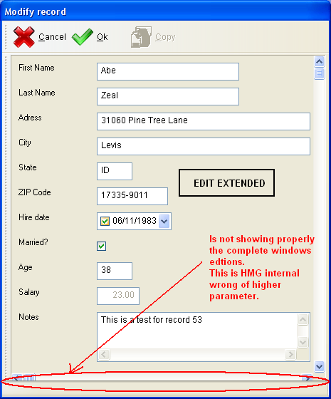

radohabjan wrote:Is there possible to have another two parameters in function EDIT EXTEND :
HEIGHT and WIDTH
EDIT EXTENDED ;
HEIGHT 300;
WIDTH 400 ;
WORKAREA SIF_DAVK ;
TITLE "Davčne skupine" ;
FIELDNAMES aFieldName ;
FIELDENABLED aFieldEdit ;
TABLEVIEW aVisTable ;
OPTIONS aOptions ;
ON SAVE bSave
I understand your question. It is due missing part of scrolling window, as showing in this image:

Work Area not in Use
Posted: Thu Aug 01, 2013 5:39 pm
For now to solve this problem:
You will need to correct in C:\hmg.3.1.5\SOURCE\EDITEX\h_edit_ex.prg file, lines:
Line 642, this: height _nAltoPantalla - 140 ;
replace for this: height _nAltoPantalla - 120 ;
AND
Line 951, this: nAlto := 15 + 65 + nAltoSplit + 15
replace for this: nAlto := 15 + 75 + nAltoSplit + 15
Save C:\hmg.3.1.5\SOURCE\EDITEX\h_edit_ex.prg file and click in C:\hmg.3.1.5\SOURCE\EDITEX\buildlib.bat (to rebuild the LIB). After this you can recompile your app.
