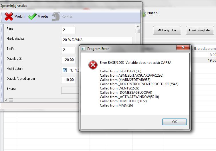

radohabjan
- Posts: 99
- Joined: Mon Nov 30, 2009 7:17 am
- Location: Slovenia
Re: Work Area not in Use
Hello Pablo,
now I have problem by save function in EDIT EXTENDED:
- Capture.JPG (68.89 KiB) Viewed 14071 times

This as the error message shows it is not finding the cArea variable. So at begining of your prg add red lines as shows below:radohabjan wrote:now I have problem by save function in EDIT EXTENDED: "Variable does not exist: cArea"
Private cArea
SET LANGUAGE TO SLOVENIAN
REQUEST HB_CODEPAGE_SLWIN
HB_CDPSELECT("SLWIN")
HMG_MESSAGES_UTF8_TO_ANSI("SLWIN")
USE SIF_DAVK SHARED
cArea="SIF_DAVK"
// msginfo(HMG_CharSetName()+" "+HMG_GetLanguage())
DEFINE WINDOW Win_1...//...
