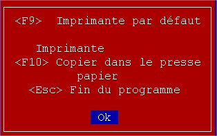

Using it in the console mode I notice a problem : see attached file. It happens when you use first F9 and after F1. In the same way french accents (like é,è,à,...) are not displayed in the console mode.
Have you tested your code program in console mode and compiled it by HMG before ? I believe something with codepage that is not configurable in HMG with french language. See source code line 39.
Even been at English here, do not displays these "y" caracteres. Too weird...

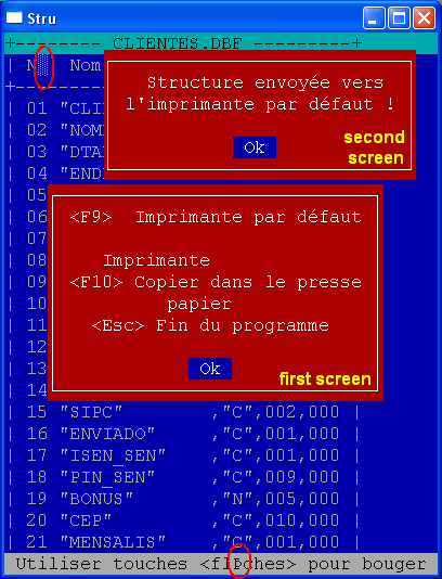

Hi Cris,
In the fact, here it doesn´t matter when we press F1 before F9, this doesn´t change exibitions of accents, as you could see first screen and second screen (in yellow).
Please, let me ask you something important: at this attached image, in both red circles made, do you see french acents when you are running STRU in your computer or visualization it is like my image attached ? (please confirm)
I believe that you are visualizing in correct way in french (not these strange caracters, like in image) then I suppose that Hb_AnsiToOem() could it be interfering when is french language because HMG/Minigui seems not applying HB_CDPSELECT() by SET LANGUAGE when is translated internally. Then, for french, probably doesn´t needs to use Hb_AnsiToOem(). But I need your confirmation if you are seeing correctly (in both circles) in your screen when are running STRU in console mode. Please confirm that.

chrisjx2002 wrote:The first time I use F1 it works : first screenshot. Everythink is OK even the accents
After I use F9 : I have no more accent : second screenshot
After I use F1 and I have no more accent and the yyyyy : third screenshot
I have another question (please let me know): You obtained these results, was when you ran STRU which version please ? (you can see STRU version when you mouse click in "A propos" in GUI mode).

I have the same problems with words flèches and N° : see attached file
I confirm that the first time I use F1 it works with accents, I use F1 a second time, a third time,.. it works with accents but if I use F9 and F1 there are these strange y which are appearing on the screen.

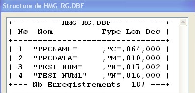

I have tested this new version. The french accents work now correctly! No more problem on the screen and when using F1 key. Thanks for this modification.
But this modification has changed the window mode : look at N° in the two versions.
Screenshot 3.8a
Screenshot 3.8a
Screenshot 3.8
Screenshot 3.8
I have seen that LISTAR() function was being called by console mode and GUI and not treated before being utilized. Now I think is working properly.
