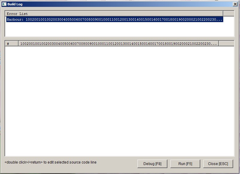

  • ONLY When built using IDE, I have come across the following problems:
    • The resultant executable file is named as n.exe and resource file is not taken care of!
    • If we have any syntax error, the log window is shown like this.
