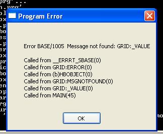

Attached herewith is the crude implementation of grid. The code is still highly experimental. The zip files contains the source code for grid and the demo_1.prg. There is an error message that I cannot find from where it originates. I tried my best to isolate it but I have no luck yet. Also I posted the error message that I encountered.

The error seems to be related to a message. I tried my best to isolate it and I even added a new property to accomodate the value on line 45 of demo_1.prg. However it seems its not the right solution. If you have any idea about that please let me know. The error message has stalled me.

You've not created a 'value' method for grid and you are not inheriting one from control, since there is not one there, so, the error is showing that.
