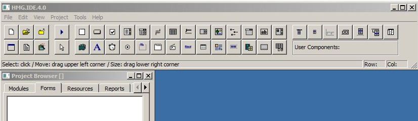

Re: Welcome to the Project Developers' Table
Wonderful :D
( The best point is : it doesn't ask confirmation when exiting ;)
Thanks a lot Maestro :)
Best Regards
First Screenshoot of new HMG.4 IDE

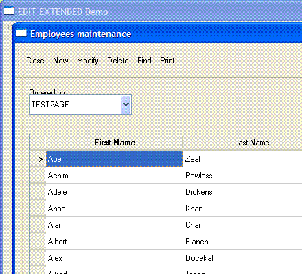

there are some things I learnt doing this:
font stuff (set font name and set font size ) should be checked, since when I invoked it ::oFont in control.prg was not defined and so RTE
in h_edit_ex all gui objects declaration must be included in define window ... end window, otherwise they have no ::oParent and RTE
in combobox (and I think other GUI object) we should reflect on a point: :onChange is set BEFORE :items so that for EACH element in items a call of onChange function is done... this is a side-effect we want or not because we may need this or not... I don't know the hmg3 behaviour...
to me, it should :onChange should be set AFTER :items and BEFORE :value() in order to force a call to onChange function
Toolbar buttons defined with this syntax:
button tbbCerrar caption _HMG_SYSDATA [128 ][1] picture "HMG_EDIT_CLOSE" action wndABM2Edit:Release()
doesn't have :name="tbbCerrar" in #xcommand and so they are not added to the window as window:tbbCerrar
More on toolbar.... to me a
DEFINE WINDOW w1
DEFINE TOOLBAR tb1
button tbbCerrar
should create an object w1:tb1:tbbCerrar and not w1:tbbCerrar....
Please also review #xcommand for button, and how it defines/destroy oCurrentToolBar... it is also a DATA member defined in window.prg but it seems to not be used
#xcommand TOOLBUTTON don't use oCurrentToolbar (they don't set a parent....)
There are no samples using TOOLBUTTON, just BUTTON and "with object" that explicitely set :parent.... so, perhaps, toolbutton should have :parent set....
