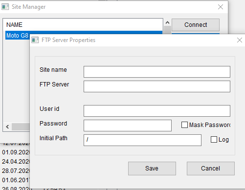

TIP: when creating a new site it should contain an Anonimous checkbox or fill in the following fields
Checkbox Anonimous.png (12.17 KiB) Viewed 10193 times
   IF xParam = NIL
      newRecord := .f.
      sites->( DBGOTO( sitemanager.browse_1.value ) )
      editsitemanager.text_1.value  := sites->name
      editsitemanager.text_2.value  := sites->address
      editsitemanager.text_3.value  := sites->user
      editsitemanager.text_4.value  := desencri( sites->password )     // decript
      editsitemanager.text_5.value  := Sites->SPath
      editsitemanager.Check_2.value := Sites->Log
      newRecord := .t.
	  editsitemanager.text_3.value  := "anonimous"
      editsitemanager.text_4.value  := "anonimous"
