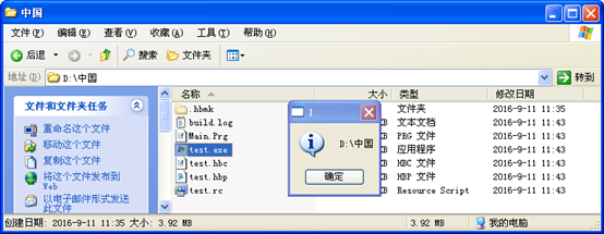

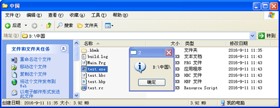

各位前辈,各位同仁:你们好,
我发现GetstartupFolder()函数存在BUG,请看例子:假定该程序运行在“D:\中国”文件下:
REQUEST HB_CODEPAGE_GBK
Function Main()
msginfo(GetStartUpFolder(),"1")
hb_CdPSelect("GBK")
msginfo(GetStartUpFolder(),"2")
return nil
运行结果: 发现输出结果不相同!
但如果使用函数GetCurrentFolder()代替Getstartupfolder(),结果是正确的!
我的解决办法:
修改文件h_controlmisc.prg 第4853行
Return HB_ULEFT ( StartUpFolder , HB_UTF8RAT ( '\' , StartUpFolder ) - 1 )
为:
Return LEFT ( StartUpFolder , RAT ( '\' , StartUpFolder ) - 1 )
重新构建LIB库,再重新编译运行程序,显示结果正常。

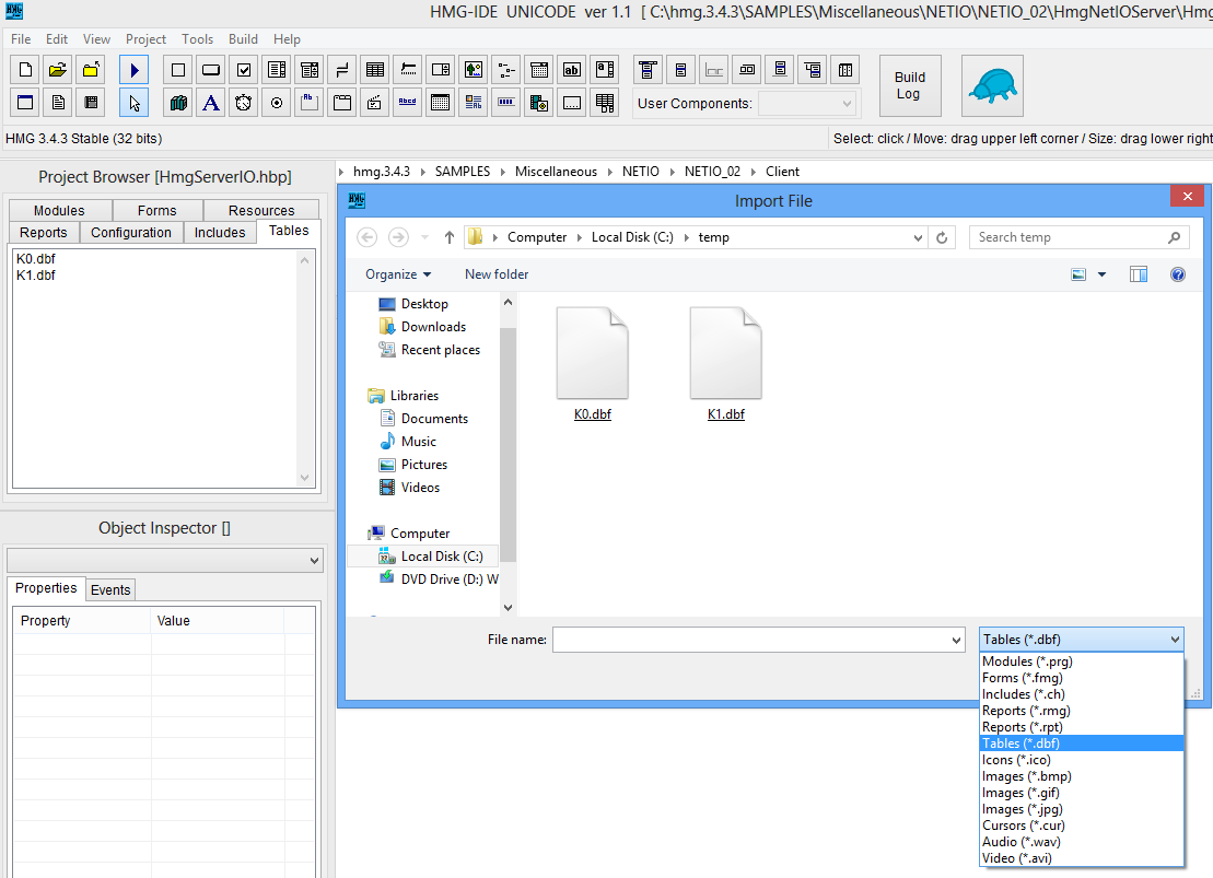

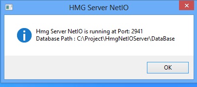

About Netio
I dont know why version 3.4.3 , 3.4.2 , 3.4.1 , I see config NetIO Servert is: C:\Project\NEIOServer\DataBase
I don't have C:\Project folder in my PC
When I edit database path is c:\temp and copy some file dbf in c:\temp but NetIO Client dont see !?
I use Window 8 , 32 bit

Re: HMG 3.4.3
You have to change Config.ini file located at "C:\hmg\SAMPLES\Miscellaneous\NETIO\NETIO_02\HmgNetIOServer"

Re: HMG 3.4.3
Thank youbpd2000 wrote:You have to change Config.ini file located at "C:\hmg\SAMPLES\Miscellaneous\NETIO\NETIO_02\HmgNetIOServer"
I fogot insert some dbf files in includes form before compiler by IDE
