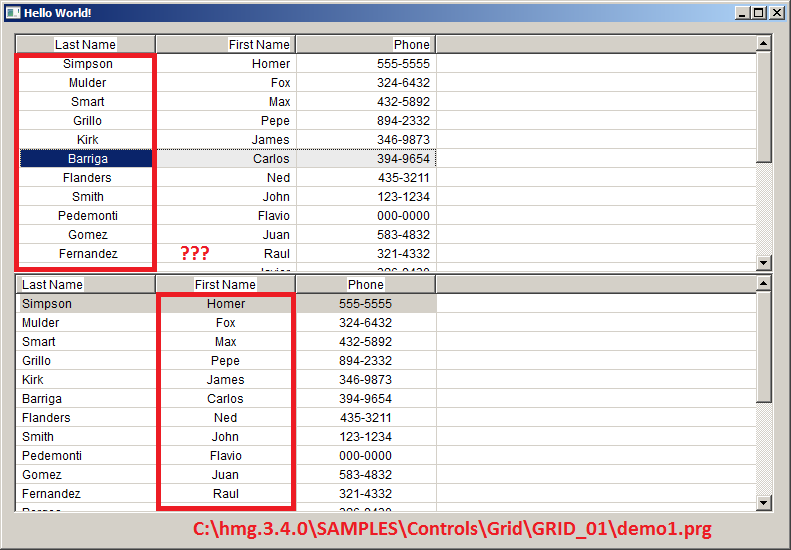

For TextBoxes and also DatePickers, right and left alignments are no problem.
But the question is when is setted to GRID_JTFY_CENTER in on column grid. :?
In TextBoxes we have not this ES_CENTER edit style.
So is it posible to use SendMessage with ES_CENTER ? (I thinks it's available at control definition only) :(
To use ES_CENTER in C:\MiniGUI\SAMPLES\Applications\WinErrors
See this attached file WinError:
WinErrors.rar
(501.02 KiB) Downloaded 309 times
Let me know if you have any idea for GRID_JTFY_CENTER cases.TextBox, it's posible.

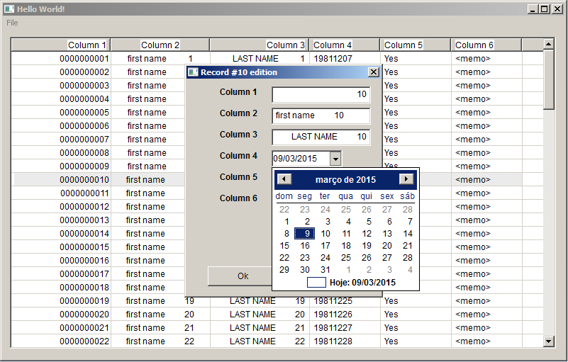

Pablo César wrote:For TextBoxes and also DatePickers, right and left alignments are no problem.
Just for clarifying about right alignment in DatePickers.
When we pass RightAlign as TRUE. The drop-down month calendar will be right-aligned with the control. Like this:
Instead of left-aligned, which is the default, will be like this:
Anyway, it was implemented at InputWIndow too.
