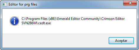

Here it is:
Local cEditor:=CheckExt("prg")

It is in xBase. You can change CheckExt("prg") by other extension file, just to make a test if Notepad++ is installed as regular installation or not. I hope you find it useful.

Re: HMG 3.1.5 (Test)
Pablo :
subo una imagen que comprueba los resultados del codigo que publico hace un rato.
2013-08-26 21_08_59-Editor for prg files.png (20.33 KiB) Viewed 5615 times
