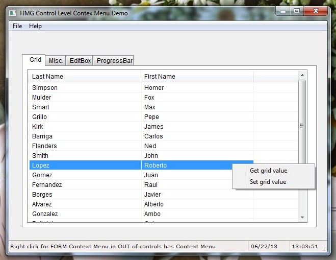

A new feature added to HMG in the 3.1.4 version: Control level context menu.
This is a demo prg for this good and important emhancement;
with big thanks and best regards to Dr. Soto.
This demo builded upon famus HMG demo : Main.Demo.
Screen shoot of CLC_Menu demo prg
CLC_Menu.zip
Source (.prg) file of CLC Menu demo prg
(2.21 KiB) Downloaded 311 times

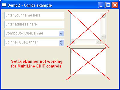

Pablo César wrote:I Based on the example of Carlos, I'm not getting even find the right handle of the control components of EditBox and RichEditBox.
Definitions of EM_SETCUEBANNER message by MSDN says:
Sets the textual cue, or tip, that is displayed by the edit control to prompt the user for information.
So these EDIT controls (EditBox and RichEditBox) should be possible to setcuebanner, but I can not find the way.
Unfortunately, has not way out for EditBox and RichEditBox, there are EDIT controls in MULTILINE mode.
I found from some internal resources (many other languages) that EM_SETCUEBANNER is only supported for single line edit box. This is not supported for edit boxes with style ES_MULTILINE.
At least now I know not to waste any more time trying to get it working.
Unless our genious :roll: could make up a trick modifying the INITEDITBOX c_editbox.c in order to simulate the same effect. Something like as creating a small window over the top of it that contains the placeholder text. Then when the user sets the keyboard focus to it hide the window and if the focus is removed and nothing is in the box then show it.
