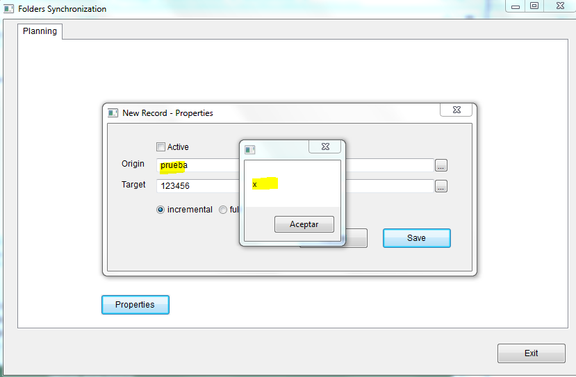

Hi, all
Something is happen with textbox control, randomly their value is not returned.
See next example:
1- Run prueba.exe
2- Hit Properties button
3- Hit Save Button
Save button execute the next code:
cTemp:=GetProperty('Win2','Text_1a','Value')
msgbox(alltrim(cTemp)+"x")
But in a randomly manner the value is not returned, sometimes msgbox shows: "Pruebax"
And sometimes only shows "x"
Attached please find short example
Thanks for your advices
Does anyone could confirm the issue with textbox?
Ed
