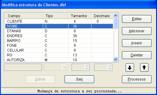

STRU - Lists and modifies the structure of the dbfs file

Now is updated with Turkish, Polish, Spanish, English and Portuguese.
You can write and press Enter at language field and will only accepts character in UPPER case and only if is part of any item of combobox. When language try to change at combobox will also check if file of language exists and will validate or not in case.
All these options could be accessed bu clicking at item of StatusBar.
Now I shall see others pendant items, with Marek regarding Polish language in console mode and for images into exe file.
Stru.rar
(1.13 MiB) Downloaded 327 times
