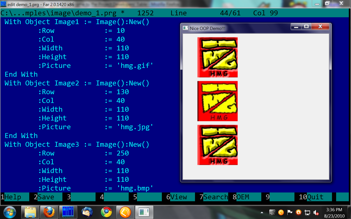

I've uploaded an image class test that works fine with .jpg, gif and bmp.
Please, take a look at it:

I've compiled your IMAGE class and get this on the screen:
So, I don't know, what's going on.

Re: Welcome to the Project Developers' Table
I too get the demo screen just like Marek.
And, when I changed all the pictures to 'hmg.bmp', all the three come up.
It looks like only .bmp files are working.
On my computers sample works good with png and bmp images. I think, basic is JPG at now and it must work.
