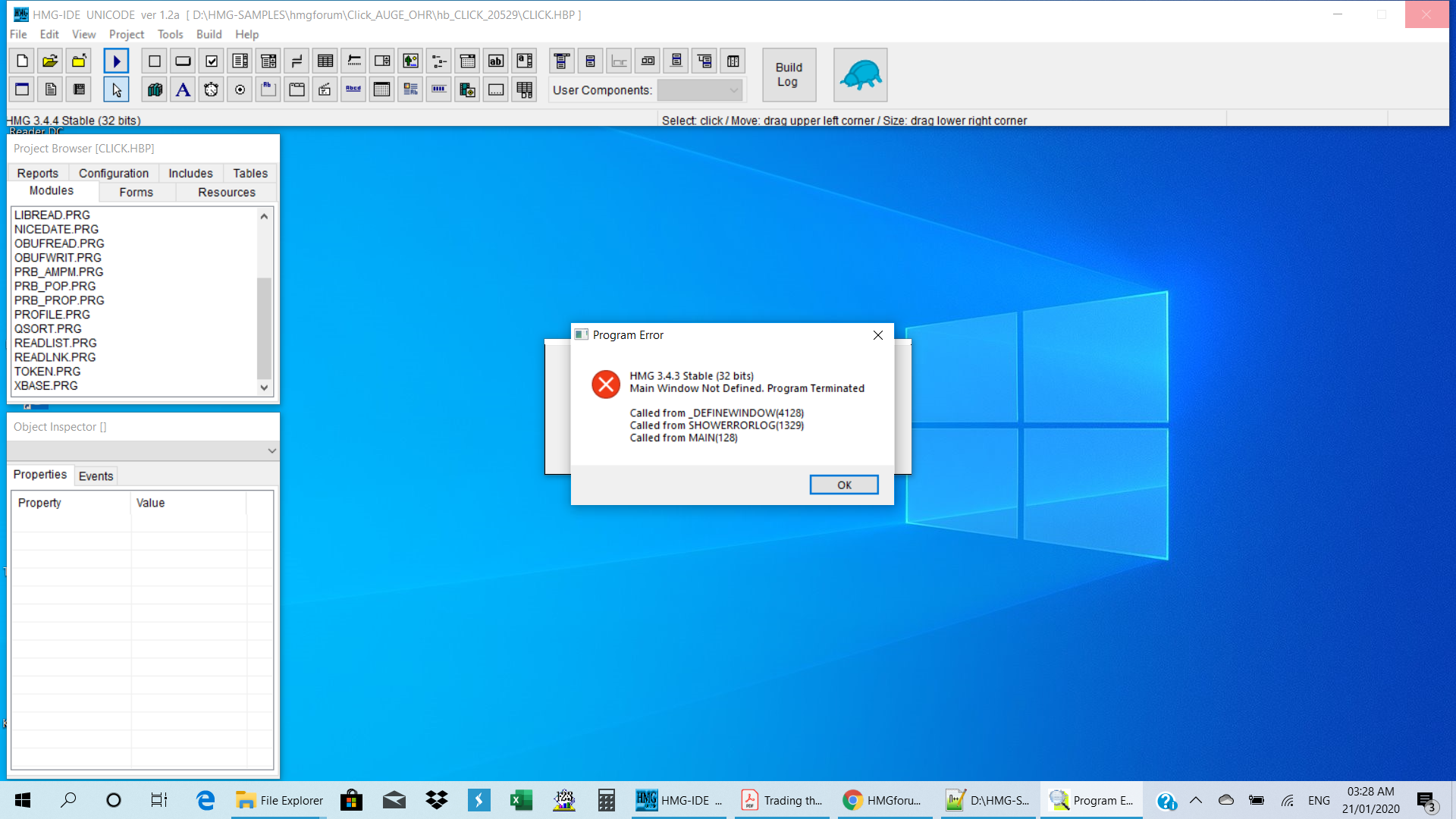

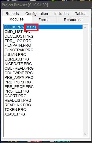

Hi AUGE_OHR
Thanks for v 2.05.29 and source code.
When I try to compile it I get error msg as per follo SS
Click20529 error msg.png (1.05 MiB) Viewed 43798 times
I am unable to tell what is the exact error.
Can you please look into it
Thanks
i can't see youe full Modul List but i guess CLICK.PRG is NOT declare as "Main"
in IDE "somewhere" i saw a Option ...
other Way was to delete CLICK.PRG from Modul List and Import it again.
my Way is to click on *.HBP.
1st time Windows will ask how to open file and i point to
c:\hmg.3.4.4\IDE\IDE.exe
and let Windows "remember"
next time when click on *.HBP it will open Project in IDE and i just press F5

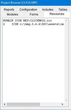

RPC
Posts: 312
Post by RPC »
Hi AUGE_OHR
Ok. Got it.
There is no \res sub dir and no clickBW32.ico file in it.
I put a dummy icon after creating \res directory and now it compiles !
Please upload clickBW32.ico file so that I can incorporate in the compiled program.
Secondly I am curious why the error mentions it as HMG 3.4.3 stable(32 bit) instead of HMG 3.4.4 which I am using to compile ?
RPC wrote: Tue Jan 21, 2020 10:56 am Hi AUGE_OHR
my Name is Jimmy
RPC wrote: Tue Jan 21, 2020 10:56 am Ok. Got it.
uuups ... forgot \RES
so delete Icon and use your own Icon but it must called
MYMAIN ICON YourResource.ICO
