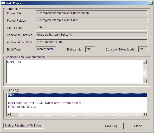

Hello Rathi,
rathinagiri wrote: Had you copied i_userOOPS.ch to include directory?
Yes I copied, but got following error:-
TIA.
With best regards.
Sudip
With best regards,
Sudip
Re: HFCL (Hmg Forum Component Library)
Hi Sudip
Does your main.prg include #include "hfcl.ch" statement ?
