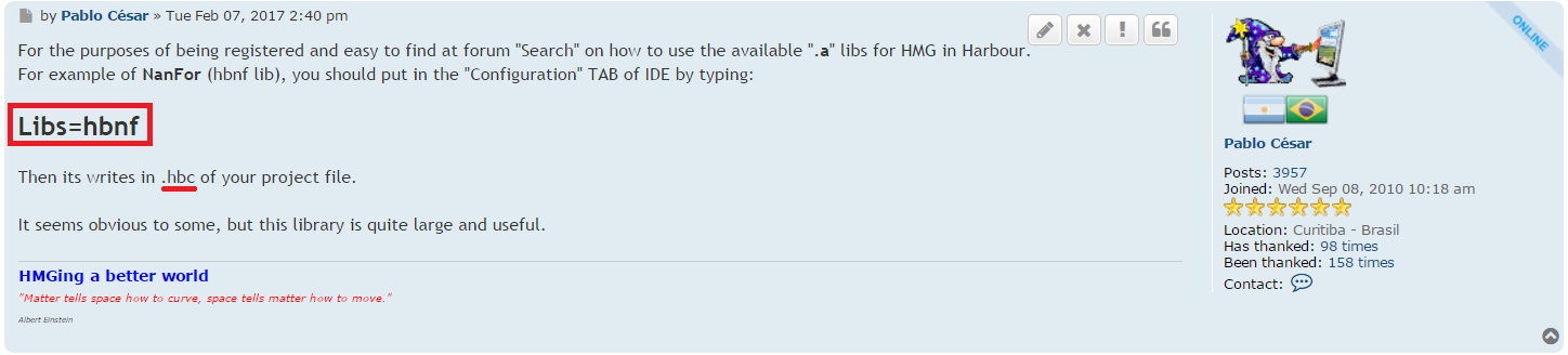

Do not put character space. Do like this:
viewtopic.php?t=2114

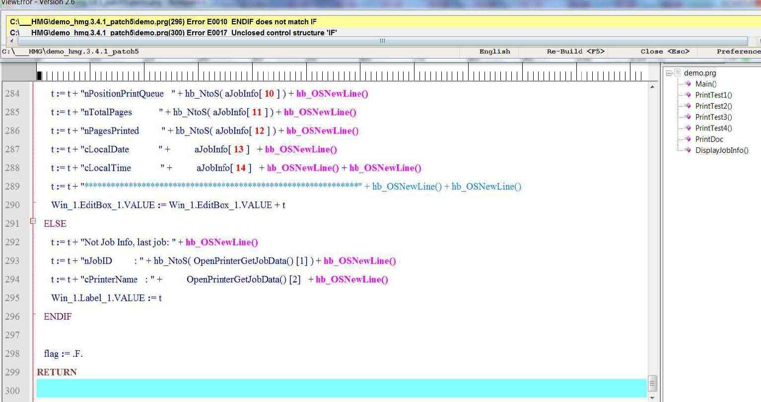

Thanks for your help. My pboblem is fixed now with your new program. I also find out why I can't attached the picture last time. It seems the format of JPG file that I created has something wrong so the file size can't be detected that caused no button for " Place inline". I attaced two pitures that I got from your program. It is great that it works now. :D

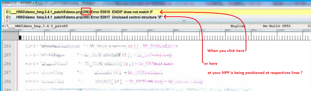

Very nice:
Please let me know also this:

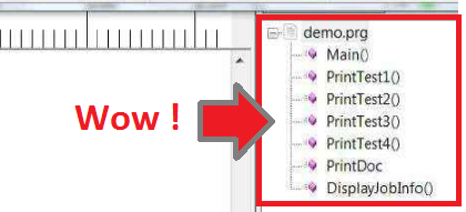

You can use arrow keys to navigate and then it shows in the respective lines. Is this working ?

Many thanks for pointing out my mistake in using "libs=hbnf"
If you look at screenshot posted by you (screen183.png) on 14 apr 2017 time 10:45 pm, you will find it contains "libs = hbnf" (with spaces) so I tried with that but now with "libs=hbnf" it is compiling without producing any errors.

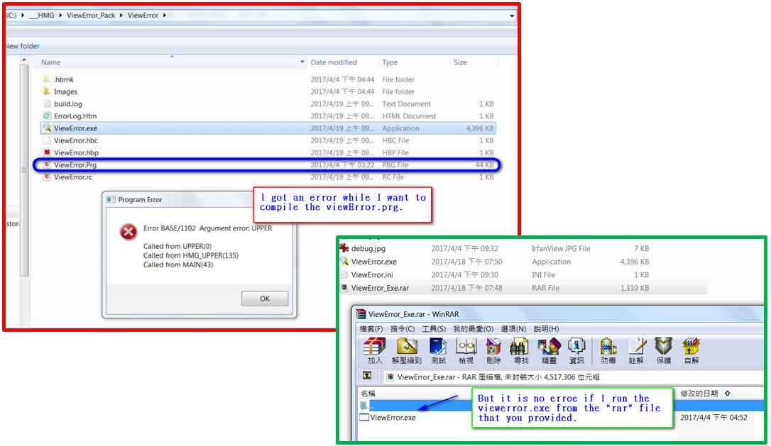

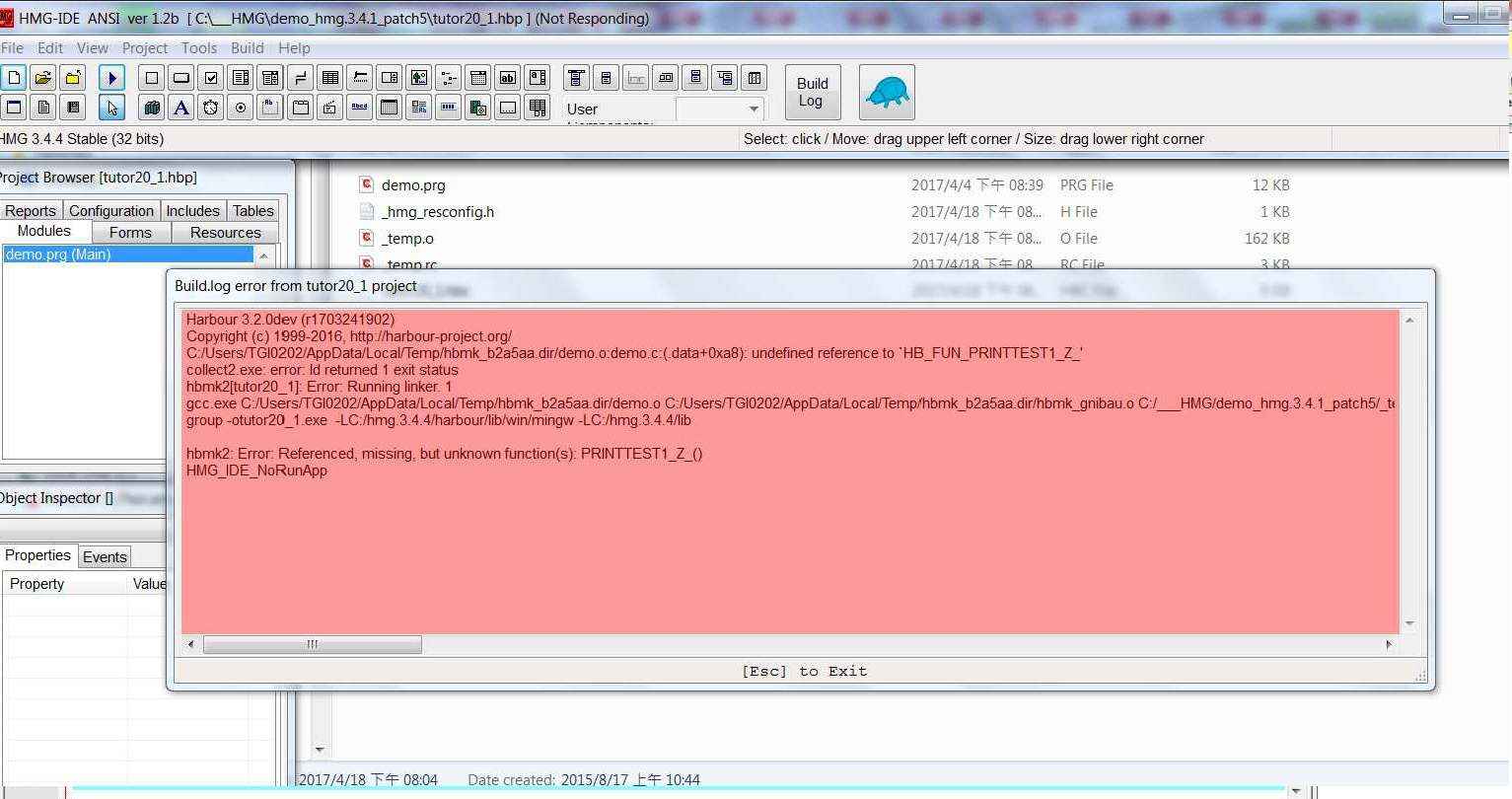

I try to compile the viewerror.prg file but I got following error message. I don't know what's wrong ...
Yes. it is works to select the arrow keys to navigate and then it shows in the respective lines. But I found I can't use the "F5" to rebuild the program ...

Hello Tiger, thank you for your interest.
In this your trying to build ViewError:
Are you using HMG 3.4.3 + 2 patches added and in UNICODE mode ?
Because in the previous line you can put this:
msgdebug(cLogFile,HMG_Upper(cLogFile))
And cLogFile even been with value Nil, the HMG_Upper will returns "".
So, here it could not with error...
Unless you are trying to compile with another version of HMG and it is not UNICODE. ViewError works on UNICODE exclusively.

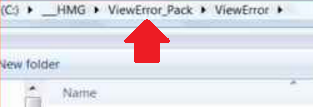

This folder ViewError_Pack at yours:
Please check it should be with this folowing folders structure:
This F5 screen is from Notepad++ because ViewError makes focus onto your Notepad++ editor.
But if you click on the main ViewError window (yellow backcolor one) and the press F5, will gonna works. :)
I hope I have clarified everything. Make sure it's as I believe it is ...
